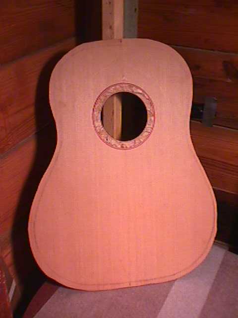

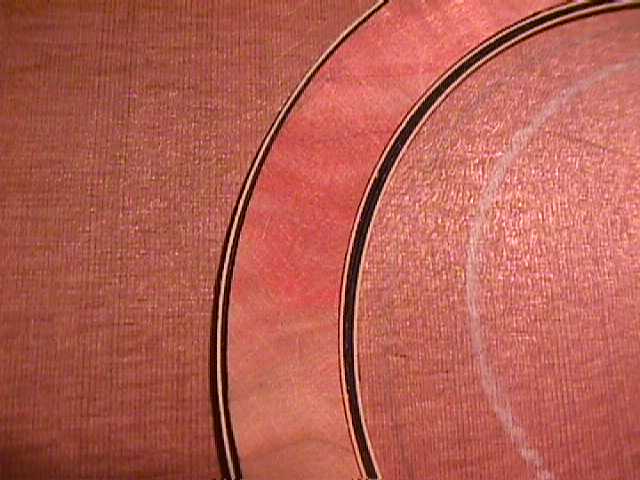

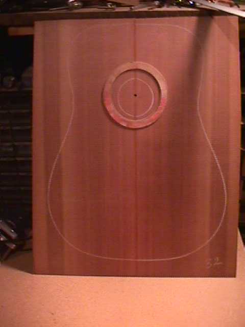

Steve, here is the rosette on the Sweet Ambrosia and a photo of the WRC Top.

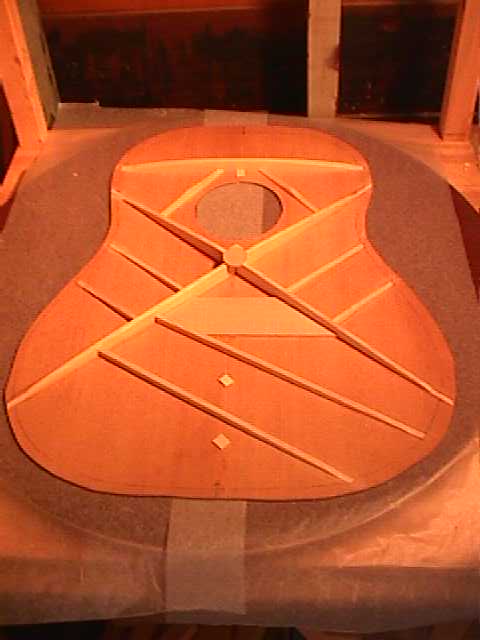

Serge, here is pic of my top bracing on the WRC - Ambrosia

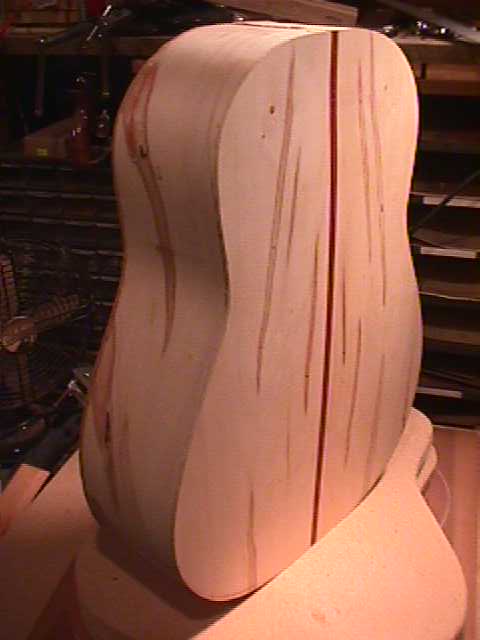

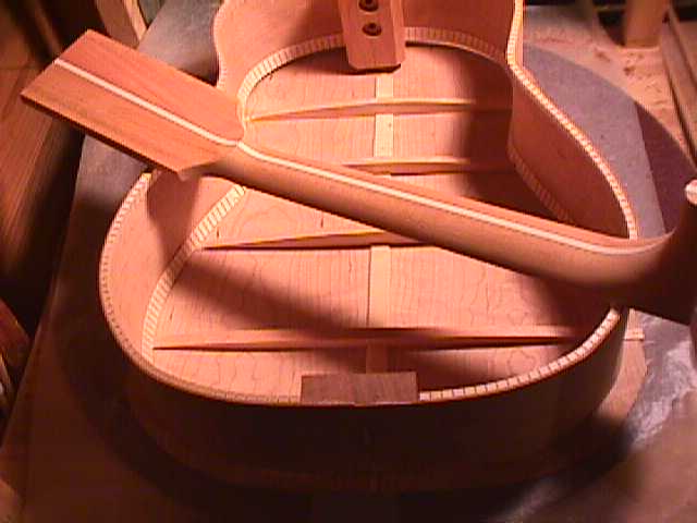

Here is an inside shot of the back bracing

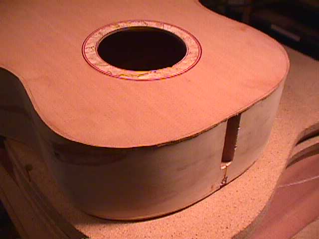

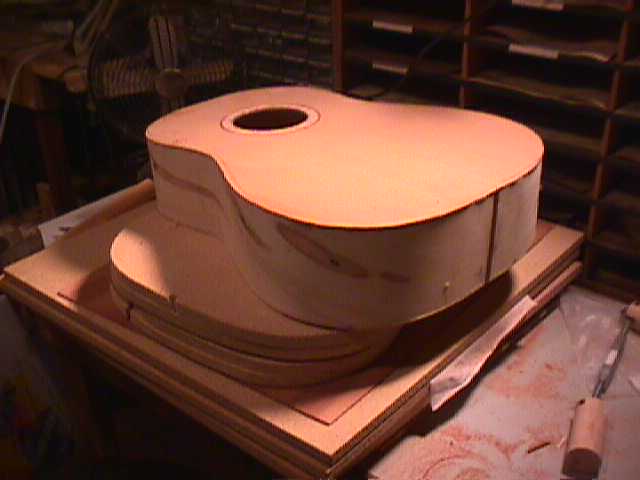

Got the box closed and trimmed out getting ready for cutting the binding & purfling ledges and install
My 2nd in this batch is the Curly Cherry with WRC Top as well. Got it ready to glue the back, this is an inside shop before glueing

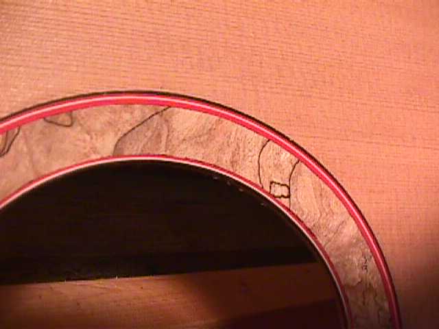

This is a pic of the wild WRC I got in from AC Tonewoods with the rosette just sitting in and not glued.
Here is a closeup of the rosette, it is some of the Zootmans new Box Alder
Here is the box with the neck on this one
The Cherry guitar will be bound using curly Maple with black purf and the neck lam and back strip all match as well.

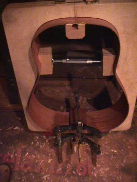

The final in the J-35 group is in line and is a Striped Sapele and here it is in the mold after setting the neck block and tail block.

PostPosted: Fri Nov 24, 2006 2:48 pm
Great stuff, Mike!
Love that rosette, and everything else to boot.
What sort of finish are you planning?
PostPosted: Fri Nov 24, 2006 3:16 pm
What Steve said! Box alder rosette -- it looks great with the ambrosia ribs/back.

Thanks Hesh, you and Colin converted me and I really like the change. The bracing on these tops are as light as I have ever worked with, no meat at all, but the tap tone is awesome. Thanks to you and Colin for answering my questions and giving info and advice.

That looks awesome... Very nice clean work and your bracing is very simillar to mine! I love the parabolic bracing as well...
My first was cherry wood and again playing it last night I kept thinking, 'Man, does this guitar have awesome tone, or what!?'... Scalloped bracing on that one though...

You're getting an impressive amount of work done there, and it all looks quite good! On your Ambrosia top, does the rosette actually go up to the edge of the soundhole, or is there a black binding too? Is there a story behind this?
